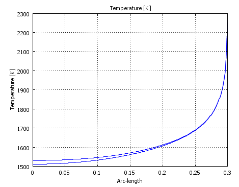

this is exactly what i have tried: a fully reflective boundary. It works quite well (see temperature_distribution.png), but there are still some differences between the results of the 1/2 model and the fully 2*1/2-model (see temperature_boundary6vs21.png). I adjusted the 1/2 model with a small plate wich covers (almost) the whole hole. The boundaray, which "looks" inside the chamber, has a temperature of 0K and has surface-to-surface-radiation with an emissivity of 0. Physically this should be a fully reflective boundary with no radiation from the plate itself, or?
But how can the difference be explained which are still left? Numerically unprecisions, since the reflective boundary has an radiative flux which is not zero (as you can see in picture radiative_flux_boundary7.png)? I would say, that COMSOL (V3.5a) can't provide an real refelective boundary, even with an emissivity of zero: If radiation energy comes from inside the chamber to the "refelctive" boundary, then the energy is absorbed and immediately emitted. But emittance does not care about the income angle (as it is correct for thermal radiation!), it is distributed along lamberts cosine law: J(alpha) = J0 * cos(alpha). For an real reflective boundary, it should be J_emit = J_absorbed but only in one direction: alpha, respectively alpha'. ???

probablky yes it could be numerical issues, as your flux is rather spiky. Have you tried to integrate fully over the area ? and see whathappens when you refine the mesh a few times ?
But it looks far better than without your reflector, no ?

I tried serveral things to improve the reflective boundary (Radiation resolution: 4096, abnormaly fine mesh size, perfectly matching reflector size and positioning using insulated pairs, sharpened tolerances, low time stepping) but the results were the same.
So i really think the major problem is, that this is a diffusive reflector and no mirror-like, specular reflector.
