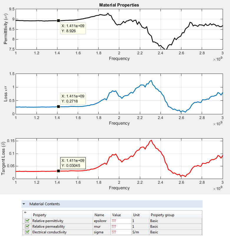

I am just confused, where should I enter the value of dielectric loss in the material properties?
I have seen some topics inte the forum, mentios that I can write it in the relative permittivity as real and imaginery part (For instance: 4-0.094i).
Furthermore,
I have also seen a topic which says I can write it in Electrical Conductivity area, doing with some calculations ( epsilon_c=epsilon-j*sigma/omega).
In the case of the following attachment, how should enter material properties?
Thanks a lot in advance.
