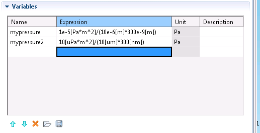

Comsol is giving us (almost) everywhere tte units calculations, I find this very handy to check my values, as we work at so many scales that counting the "0" or the "E-nn" is easily erro-rprone. COMSOL flags unit inconcistencies by setting the equations (or eqution set for vector input) in orange, while red is for syntax typing errors, missing )] or whatever.
Now Comsol cannot always understand what we want so it might end up with funny units requeirng some handcalculation to check if correct. You can help COMSOL to choose your units by slightly modifying the one we use, such as for "mypressure" see image:
1[N]/(1[m]*2[m]) => 0.5[N*m/m^3]
while
1[Pa*m^2]/(1[m]*2[m]) => 0.5[Pa]
Then when using the / division operator with values & units, use enough brackets () as the units tend to be forgotten and the result is not always as expected (was required in V3.5, somewhat less important in V4)
