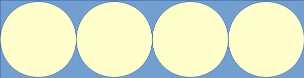

I have added another picture to describe my question. I hope this helps!

Hello Paul,
You could use a boolean expression in your integrand, something like
maxop(u*(dom==1))
to compute the max on domain 1, etc.
Hello Paul,
maxop(u*(dom==1))

Hey Jeff,
Thank you very much for the answer. I have tried this command with the temperature:
maxop1(T*(dom==1))
but I get 0 [K]. I have also tried to input dom==6 (I only have 5 domains) and it gives the same results. Any idea what am I doing wrong?
Paul
Hey Jeff,
maxop1(T*(dom==1))
Paul

Oh, I have just realized that because of the way the geometry is built, the assembly is split in even more domains. But still, if I plot dom==1, I have 0 [K], which is weird.

Oh, I had the selection of the maximum operator only on the circles. Now it works! Thank you very much, Jeff! You have saved me hours of time spent for setting different formulae and operators.
[QUOTE]
Hard to say without seeing your file. Please post it if possible.
PS: That it returns 0 with dom==6 makes sense since the boolean expression is false and therefore evaluates to zero.
[/QUOTE]
