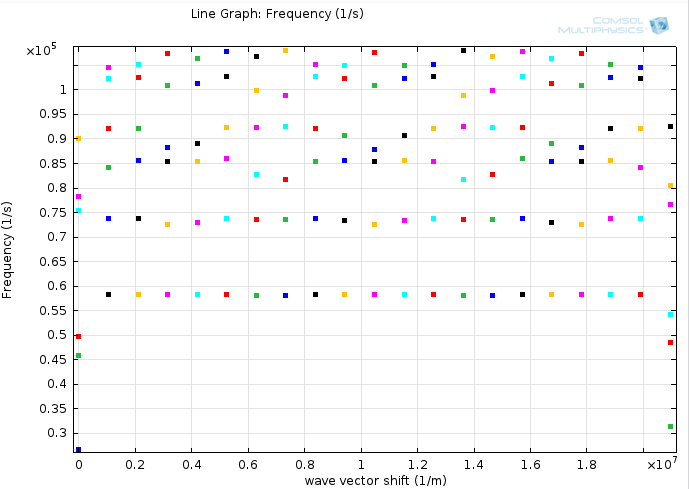

Posted: 2 decades ago 23 oct. 2009, 05:01 UTC−4
Hi Sean,
Thanks again for your mail.
For a rectangular crystal of length, the k* in the x direction would be pi/d. Thus, varying k from 0 to pi/d no sudden changes should be observed, but the bands. Am I right?
Instead I observed them. (bloch4.m)
After several trials without results with my models, I've decided to take your .mph file (eigan_periodic_test.mph, the one you sent in you first message), change the periodic boundary conditions (with the constrictions of the Bloch theorem: p=p·exp(kx*x) and idem for the y) and loop for kx while ky=0.
The file is attached (sean4.m). The result is very strange: the values of the eigenfrequencies are always the same for different 'kx' but with changes of sign. Do you know why?
Thanks a lot!
Rubén

Posted: 2 decades ago 23 oct. 2009, 11:32 UTC−4
I looked at your code and there are some problems. Firstly, the normalized wave vector for a square lattice will go from 0 to 2pi/a not pi/d. Second, you need to make sure you are establishing periodic boundaries for x_velocity,y_velocity, and p in your geometry. My advice is to make sure, make absolutely sure (as this is what held me up when I was trying to figure this out) that all of your dimensions are correct and that you are varying k* over the proper scale.
boundary conditions should look something like this
% Scalar expressions
fem.expr = {'u1','u*exp(i*kx*x)', ...
'v1','v*exp(i*kx*x)', ...
'p1','p*exp(i*kx*x)', ...
'u2','u*exp(i*ky*y)', ...
'v2','v*exp(i*ky*y)', ...
'p2','p*exp(i*ky*y)'};
where kx and ky are constants that you vary in a loop
make sure also that if you change the geometry that you rescale k*
hope that helps
Sean

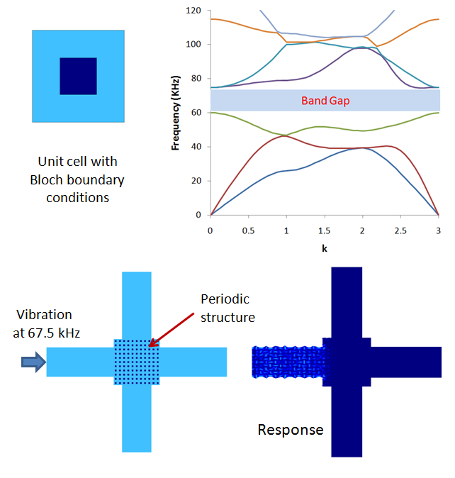

Posted: 1 decade ago 16 oct. 2012, 13:57 UTC−4
I used COMSOL a while back for a similar problem involving the band gap of a phononic crystal (see attachment). At that time I had to implement the Floquet/Bloch boundary condition manually. Now it is available as a boundary condition for structures but I have not yet tried it. You define it by creating a Periodic Condition and in Type of Periodicity select Floquet periodicity.
Nagi Elabbasi
Veryst Engineering
I used COMSOL a while back for a similar problem involving the band gap of a phononic crystal (see attachment). At that time I had to implement the Floquet/Bloch boundary condition manually. Now it is available as a boundary condition for structures but I have not yet tried it. You define it by creating a Periodic Condition and in Type of Periodicity select Floquet periodicity. Nagi Elabbasi Veryst Engineering

[QUOTE] I used COMSOL a while back for a similar problem involving the band gap of a phononic crystal (see attachment). At that time I had to implement the Floquet/Bloch boundary condition manually. Now it is available as a boundary condition for structures but I have not yet tried it. You define it by creating a Periodic Condition and in Type of Periodicity select Floquet periodicity. Nagi Elabbasi Veryst Engineering [/QUOTE] Thank you guys both. Yeap, that was my bad, I should have written 4.2 instead of 4.3. It seems that it is fixed in 4.3 but you cannot apply Floquet boundary in 4.2. Nagi: did you draw the eigenfunctions in your band diagram with Acoustic module? Ruben; Good that you are still working on this. Seems that you have been working on this subject for a while. Anyways, I don't have the 3.5 to check the .mph and .m files you and Sean have uploaded in 2009 but it seems you already solved this with MATLAB livelink. I just have started to work on this and wonder if it is possible to draw the band structure with Acoustic or PDE interface or it needs MATLAB livelink. I would welcome any comments. Alireza
Posted: 1 decade ago 17 oct. 2012, 00:07 UTC−4
Thanks Alireza,
Actually that is an Excel generated plot. I had a very similar one generated within COMSOL (no modules were required I believe).
Thanks Alireza, Actually that is an Excel generated plot. I had a very similar one generated within COMSOL (no modules were required I believe).

Nagi,
Which solver did you use? Stationary or eigenfrequency? How did you plot the eigenfunctions?
[QUOTE] Thanks Alireza, Actually that is an Excel generated plot. I had a very similar one generated within COMSOL (no modules were required I believe). [/QUOTE] Nagi, Which solver did you use? Stationary or eigenfrequency? How did you plot the eigenfunctions?
Posted: 1 decade ago 17 oct. 2012, 15:17 UTC−4
Alireza,
I used an eigenfrequency solver with a parametric sweep over the wave number, and modified its settings to handle complex numbers and the complex Hermetian matrices. For plotting in COMSOL I generated a 1D Plot of that solution Data Set.
Nagi Elabbasi
Veryst Engineering
Alireza, I used an eigenfrequency solver with a parametric sweep over the wave number, and modified its settings to handle complex numbers and the complex Hermetian matrices. For plotting in COMSOL I generated a 1D Plot of that solution Data Set. Nagi Elabbasi Veryst Engineering

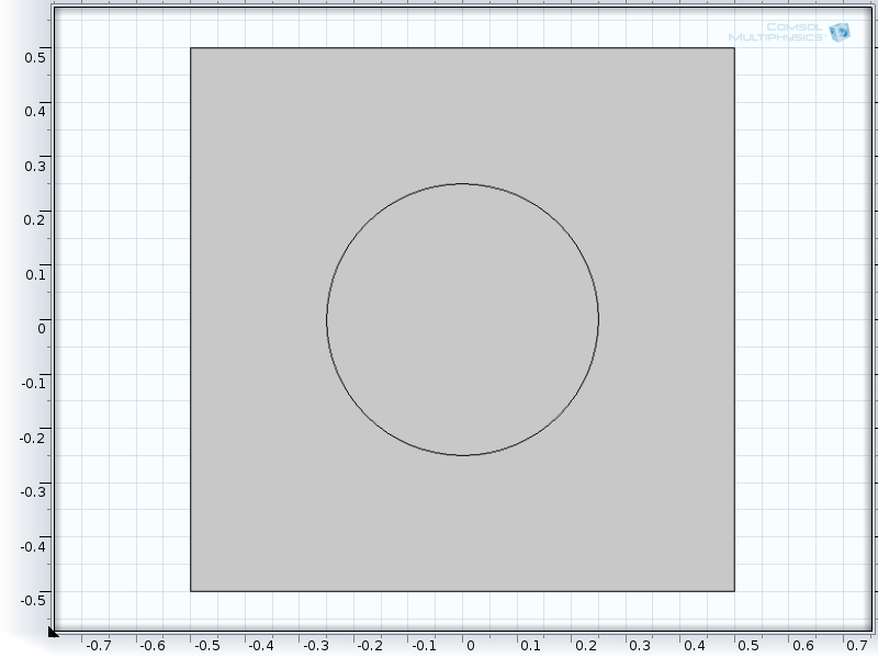

Posted: 1 decade ago 10 juin 2013, 18:26 UTC−4
Hi Alireza,
May I know how actually do you manage to plot a bandgap. I have been trying to do using the bandgap_photonic_crystal_sbs example but to no avail. Basically I am trying to model a 2D structure as shown in the attached photo.
What I've done so far is making sure that the mesh at the boundaries are the same by copying one edge of the rectangle to the rest of the boundaries. I then set the kx and ky in the floquet boundary condition using the example in the bandgap_photonic_crystal_sbs.
I then used the parametric sweep in the study computation. When i plot k against the eigenfrequency, I always get the same plot no matter what I did to the dimension of the rod. Should I use 1 or 2 boundary conditions?
I would appreciate if you or anybody else can help. Thanks.

Posted: 1 decade ago 10 juin 2013, 23:16 UTC−4
Hi Zularifin
I followed the same approach as in "photonic bandgap" example and defined two boundary conditions for parallel boundaries of the square.
Hi Zularifin I followed the same approach as in "photonic bandgap" example and defined two boundary conditions for parallel boundaries of the square.

i did the band structure for 1D periodic structure of phononic crystal but the curve is not good as show in the attached image .....any one has any help ??

I uploaded a COMSOL file to the Model Exchange that shows how to set up a phononic band gap eigenfrequency analysis. Here is the link: www.comsol.com/community/exchange/432/.
Nagi Elabbasi
Veryst Engineering
I uploaded a COMSOL file to the Model Exchange that shows how to set up a phononic band gap eigenfrequency analysis. Here is the link: http://www.comsol.com/community/exchange/432/. Nagi Elabbasi Veryst Engineering
Nagi Elabbasi
Veryst Engineering
