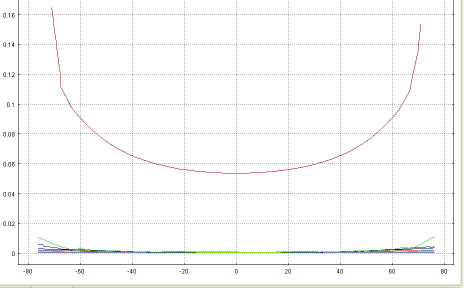

I guess my previous post was not clear, I'll try to clarify this one with some screen shots.
I am running a parametric simulation on parameter d_sep - this controls the separation distance between 2 objects.
I am generating a 1D plot using a cutline which depends on parameter d_sep.
When plotting all parametric instances I get the plot seen in plot output.jpg.
HOWEVER, this is really the output for all parametric instances with the cutline determined using the final value for d_sep as opposed to a separate value for d_sep.
That is to say, the cutline is determined based on parameter d_sep from the global definitions parameter, which is understandable. Is there a variable I can use in my cutline definition that would generate a different cutline related to each parameter?
-Yusuf
