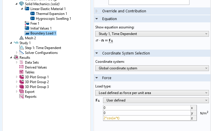

Hello, all. I want to simulate dynamic problem with adding physics of "solid mechanic" and study of " time-dependent". I want to setup boundary load with 25*sin(w*t), where "w" is frequency, which is 0.75 [s-1]; however, it show "unexpected unit of input".
Did anyone one know what unit is conflict with time ( t[s] ) in solid mechanic?

Careful! In 3D, by default, w is the displacement in the z direction, and its dimension is a length. Better pick some other name for your angular frequency!
Besides, 2*cos(omega*t) is a scalar, whereas 2[N/m^2]*cos(omega*t) is a pressure.
Careful! In 3D, by default, w is the displacement in the z direction, and its dimension is a length. Better pick some other name for your angular frequency! Besides, 2*cos(omega*t) is a scalar, whereas 2[N/m^2]*cos(omega*t) is a pressure. Jeff
