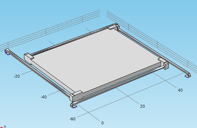

FREQUENCY ANALYSIS OF A VIBRATING E AND J SHAPE ISOLATOR
Posted 20 nov. 2015, 18:36 UTC−5 0 Replies

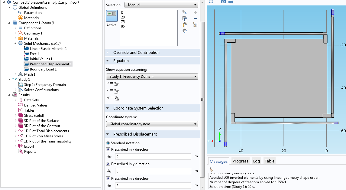

1. Should i used the "Prescribed Displacement" model to defined the initial displacement.
2. Or is should use the "Boundary Load" to defined the initial displacement.
3. How can I compute the "Transmissibility" of the system. Its given as the "magnitude of J shape displacement over magnitude of the disturbing vibration
Find attached a picture of the figure. Thank you.
