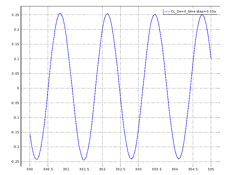

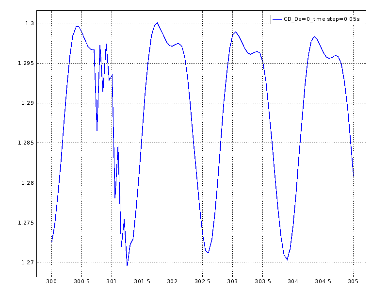

I got the attached results for lift and drag coefficient using "reacf()" function.
Please take a look at them.
I guess I should decrease the time step further.
Regards
Iman
Also, you can calculate your required time.step roughly too. Assume a Strouhal number of say 0.15 and calculate the frequency. Then period. And finally your timestep should be like 1/20th of a period for enough accuracy.
I did that. I can also use Lift coefficient graph to find frequency.

The CD graph is so erratic as you see in attachment. I don't know why?
Another problem is that the average Lift coefficient is not exactly zero. it seems the field is not perfectly symmetric, but as I checked It is totally symmetric .

Sorry, I answer u a bit late.
As I decreased the time step and used "reacf()" for calculating drag coefficient, I got an acceptable result in this case. So the problem is solved :)
