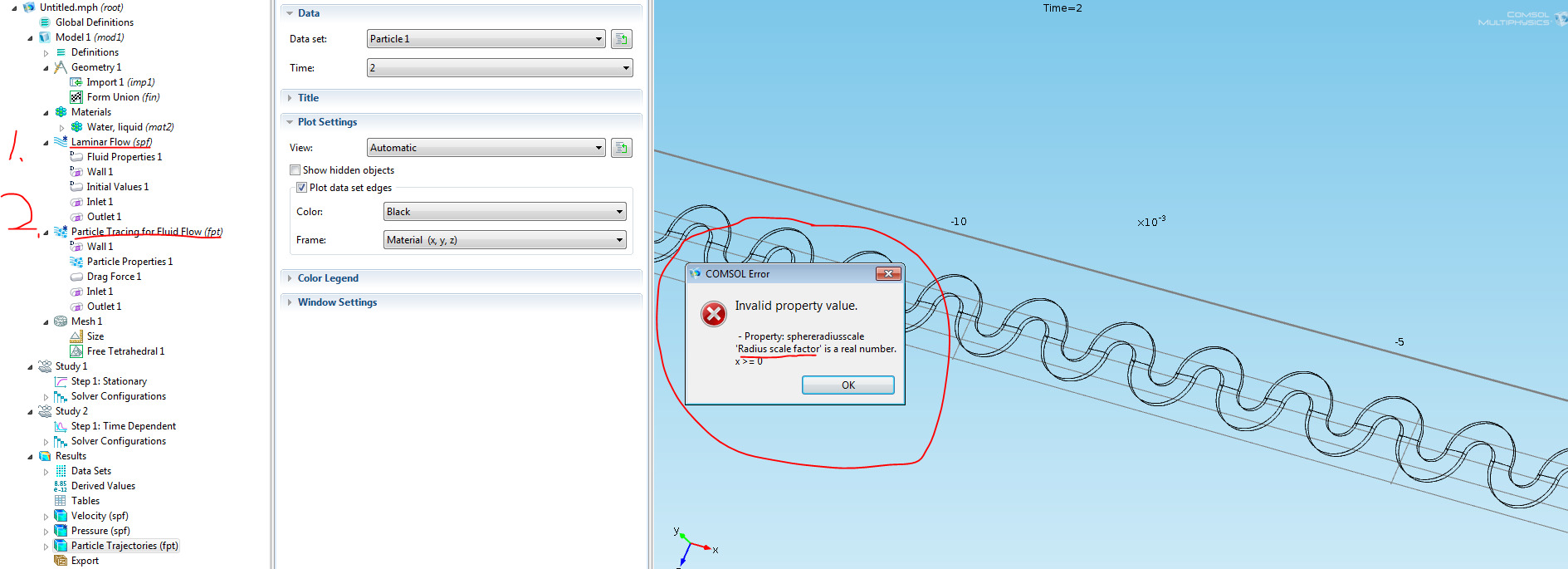

I have a problem when I run a simulation about particle tracing. Its about the particles in the laminar flow. I can compute the first step , laminar flow, with no problem. however after adding another physics, particle tracing, i cant compute and always receive a error message.
The error message is,
Invalid property value
-property: sphereradiusscale
"radius scale factor" is a real number.x>=0
because i can compute the first step, i think its not for the reason of the geometry. Does anybody have idea to solve this problem?
THe attachment is the pic of the problem.
best regards,

This might have happened due to not properly specifying your units.
I just had a similar error that occurred because I didn't properly specify the units in the parameter value list for a parametric sweep. For example, you want to use:
{1,2,...n} [m/s]
and not:
1,2,...,n [m/s]
This might have happened due to not properly specifying your units. I just had a similar error that occurred because I didn't properly specify the units in the parameter value list for a parametric sweep. For example, you want to use: {1,2,...n} [m/s] and not: 1,2,...,n [m/s]
