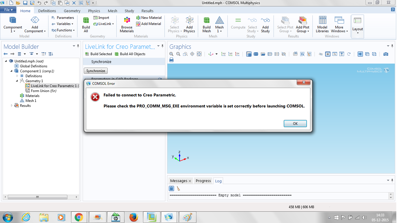

I tried the livelink option for creo parametric 2.0. but when I tried to synchronise an error message appeared.
Failed to connect to Creo Parametric.
Please check the PRO_COMM_MSG_EXE environment variable is set correctly before launching COMSOL.
I have also attached the screenshot. please help me in importong file to comsol from creo parametric.
I tried the livelink option for creo parametric 2.0. but when I tried to synchronise an error message appeared. Failed to connect to Creo Parametric. Please check the PRO_COMM_MSG_EXE environment variable is set correctly before launching COMSOL. I have also attached the screenshot. please help me in importong file to comsol from creo parametric.
