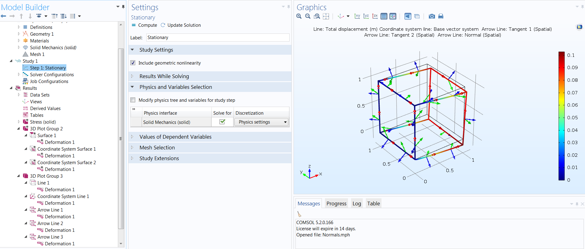

Yes, I have made some toy models myself, I believe the behavior has changed from the early V4.x days, that was last time I was fighting with these t&n's ;)
Still to really catch all dependences, I suggest that you make a 3D "toy model" i.e. structural a cube of 1[m] side, give it a Solid physics, E=1E3, nu=0.3, rho=1, then fix one boundary of the cube and apply a gravity -g_const diagonal along all X,Y,Z, Solve as Stationary with "include geometric nonlinearity"and plot the results with surface and line plots, as well as Coordinate plots (of the boundary coordinate system.
I see then that the boundary coordinate system "sys1" is not defined on the Edges, only on the Surfaces/Boundaries, but the (t1,t2,n) vectors are defined everywhere, and that on the Edges these are not Cartesian, but that is expected, if you think over it

                                                    thanks,
that is nice, I thought that if defined sys.t1 to be "manual" the sys. would be the same system as the to t1x..,t2x.., nx.. but that is not correct : in this case both systems would point to the same direction but still as you wrote sys is not defined on edges..I didn't notice that
thanks for the model, it was very useful to see more way to analyze the results I understand it better now :)
