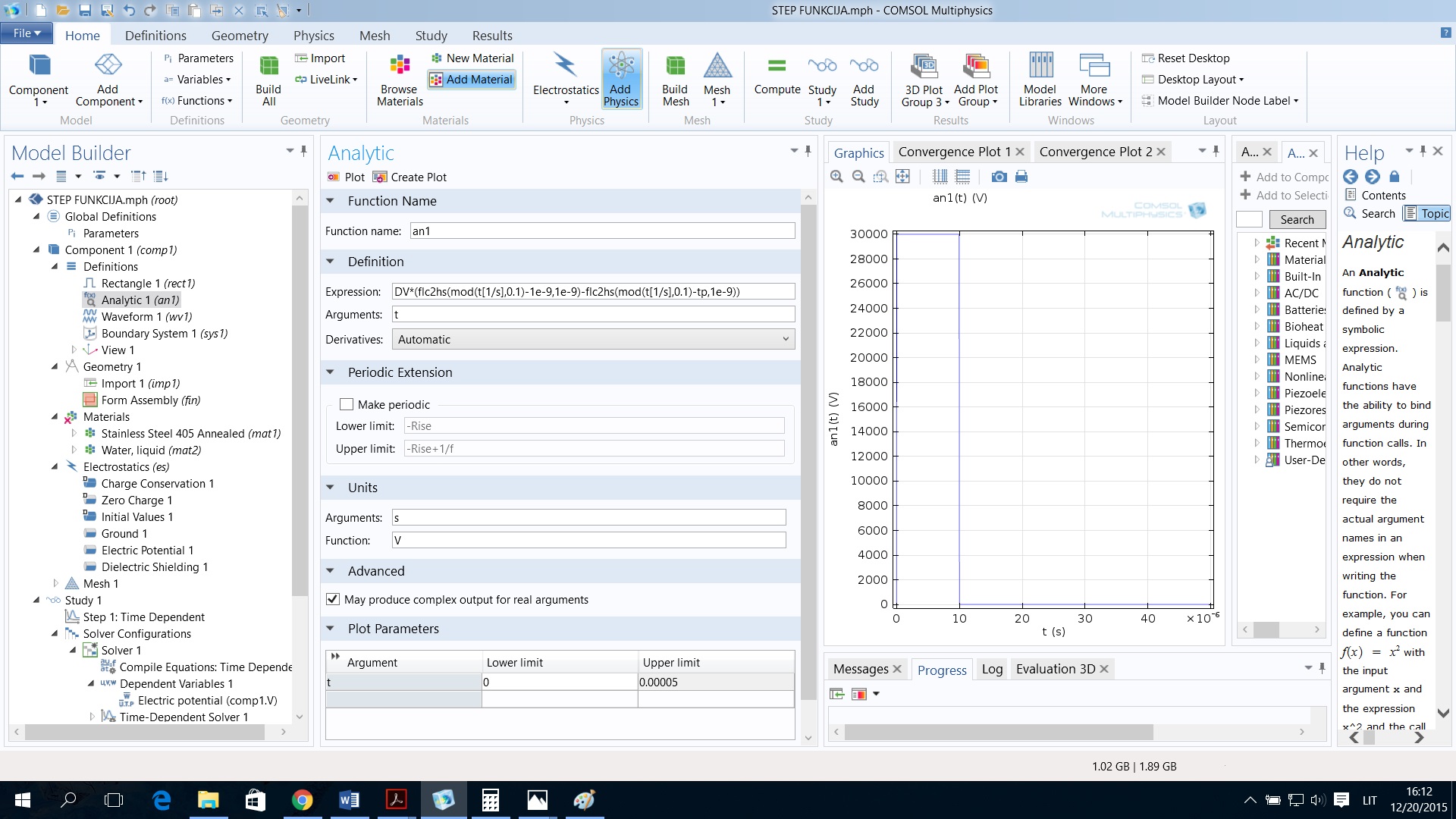

I am trying to make a square pulse train, and was read a lot of forums for this..but unfortunately I didn't get pulse train...just one 5us pulse with DV amplitude..
My rectangular pulse train function is:
DV*(flc2hs(mod(t[1/s],0.1)-1e-9,1e-9)-flc2hs(mod(t[1/s],0.1)-tp,1e-9))

The function seems to be correct. You are just not plotting far enough and you have to create a plot with a high resolution grid dataset (100000) otherwise you don't resolve the sharp spikes in the plot.
If you are planning to use this in a time dependent study, you have to take care that the time stepping resolves the spikes. The rectangular pulses will probably get the solver into troubles. You may have to make it smoother.
