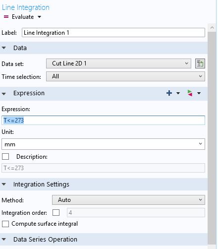

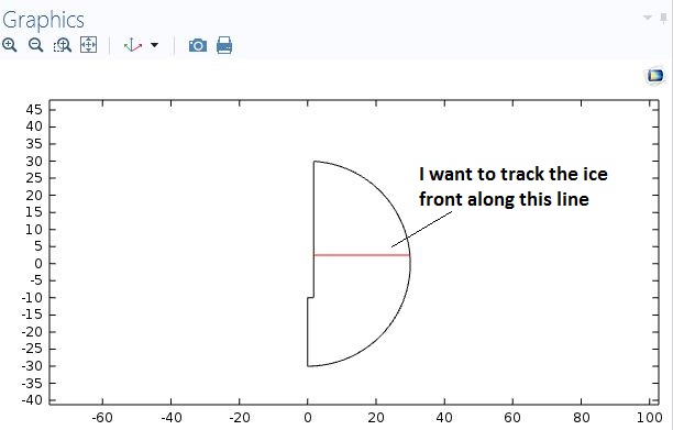

Tracking the position of a constant temperature
Posted 21 déc. 2015, 08:23 UTC−5 Heat Transfer & Phase Change, Parameters, Variables, & Functions Version 5.0 0 Replies
Hello JY Chan
