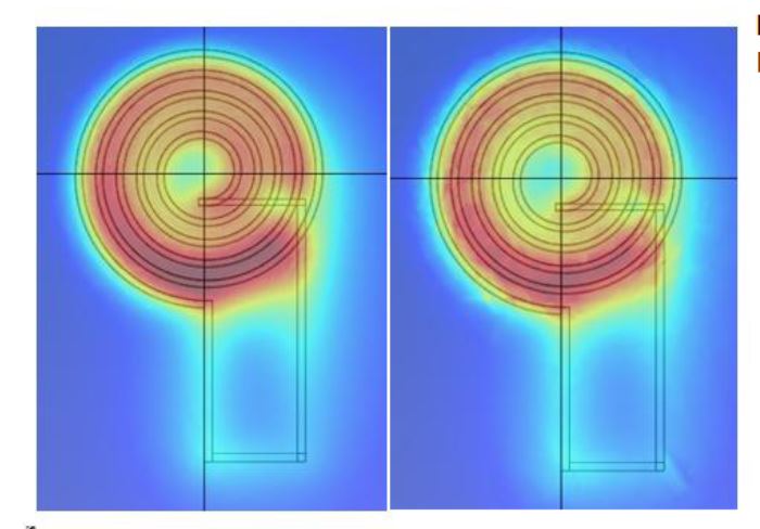

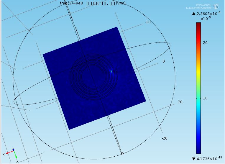

I want to simulate the antenna electric field intensity.
but the result is too small and strange.

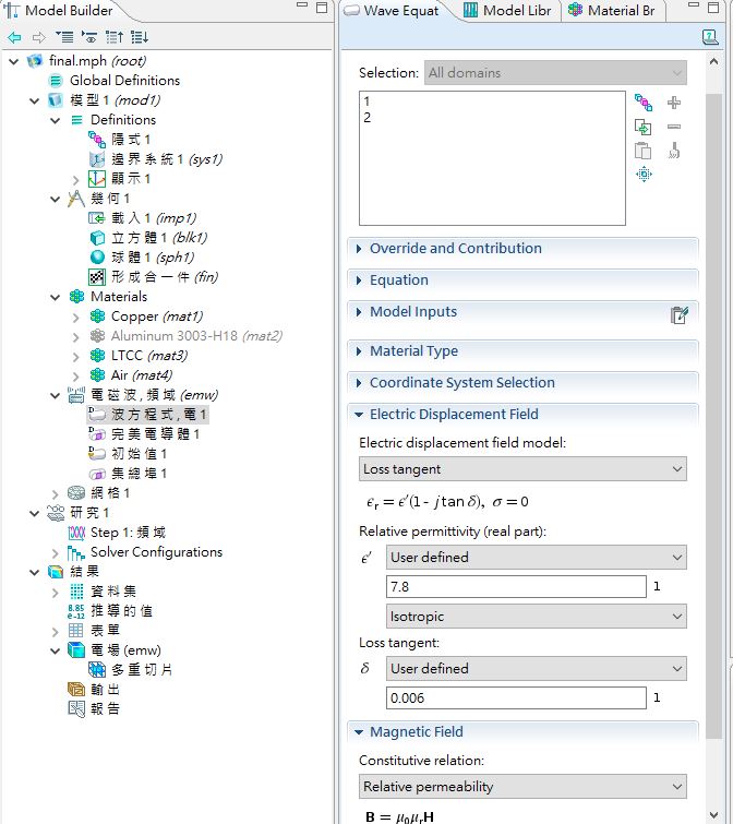

I need to try the impedance boundary or some other ?
the file is too large so I add some picture.
the fig.c is my expect .

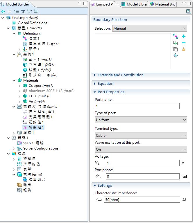

Posted: 10 years ago 6 janv. 2016, 14:05 UTC+1
it seems you haven't assigned a boundary in the port node.
Cheers
Edgar
