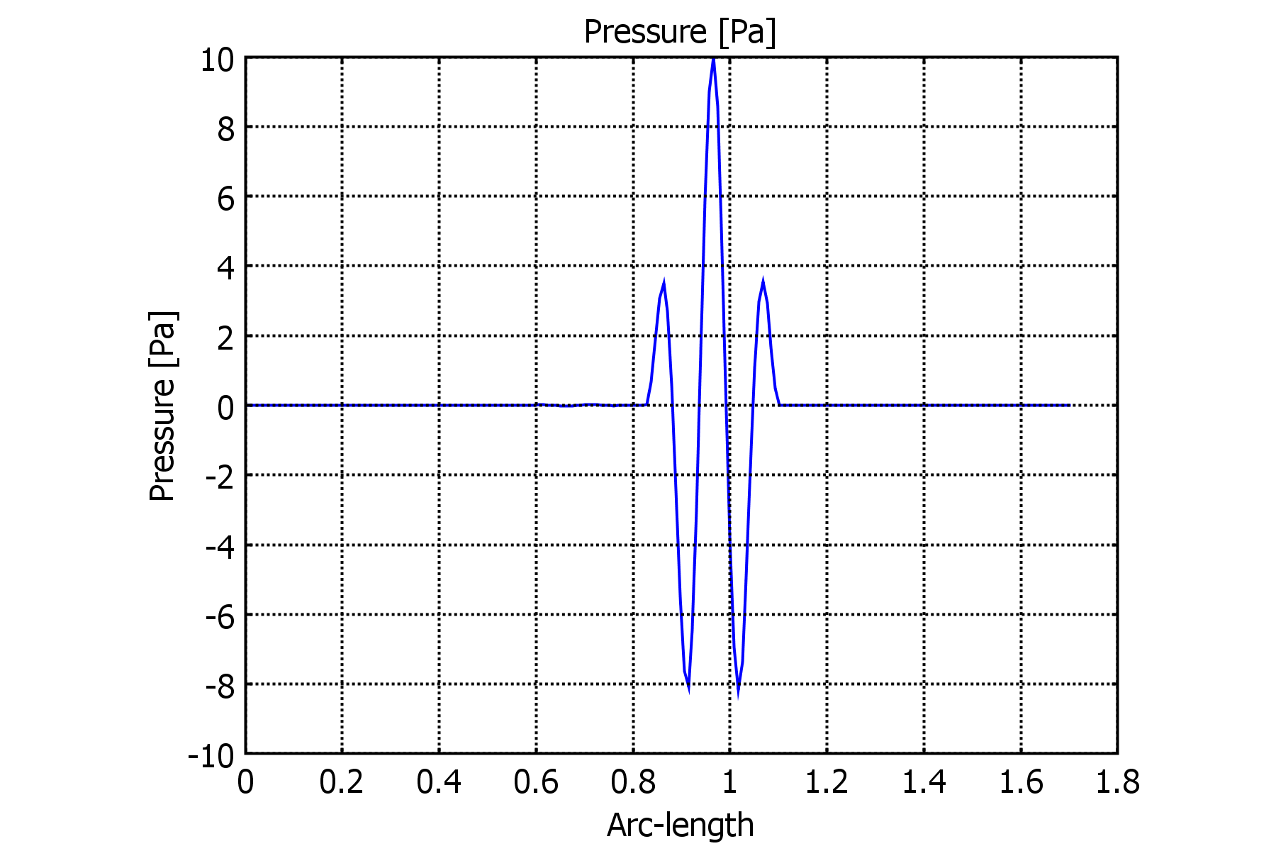

I'm having a problem with the Pressure-Acoustic module, specifically with the boundary conditions. What I'm modeling is a wave propagation in a pipe filled with water, what I'm using to model this is the pressure-acoustic transient analysis with axial symmetry and with a pulse generation at one end of the pipe as a boundary condition for a short time.

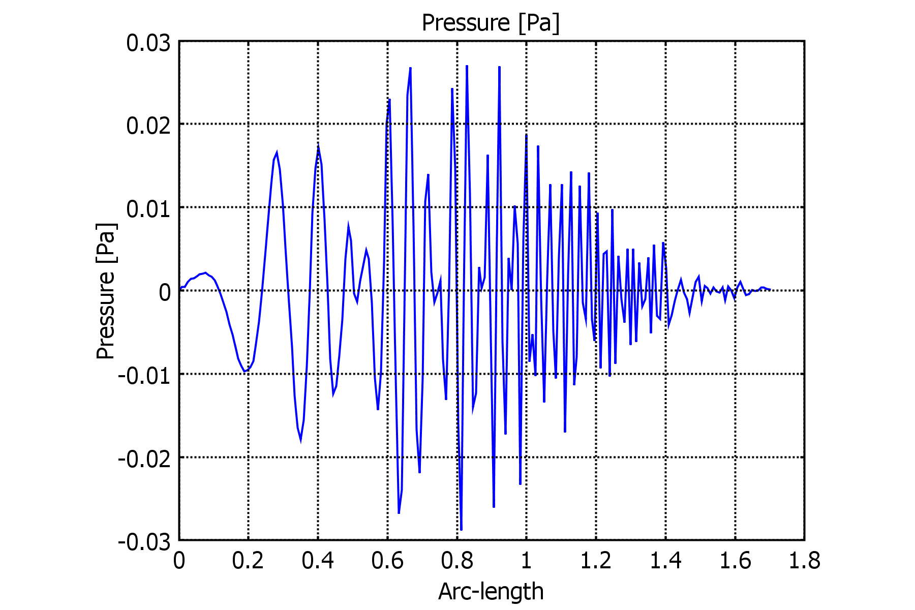

Here's the problem, when I set the sides of the pipe with hard wall condition (dp/dr=0) I get a reasonable pulse propagation but when I set the side of the pipe to soft wall (P=0), the data that I obtain of the pulse don't make any sense.
What I think that it might be the problem is due to a discontinuity between the condition in the side of the pipe with the ends of the pipe.

I attached two plots with the results. If Somebody can help me I would appreciate the help.
