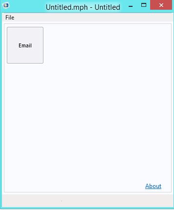

I wrote the following code (I attached a screenshot for my simple application) :
EmailMessage mail = new EmailMessage();
mail.setFrom(emailFromAddress());
mail.setTo(userEmailAddress());
mail.setSubject("COMSOL notification");
mail.setBodyText("Done");
mail.send();
When I run the application builder and run it, it gives me the following error:
Failed to send email.
failed to connect, no password specified?
Why does this error show up although I set the password in the preferences?
