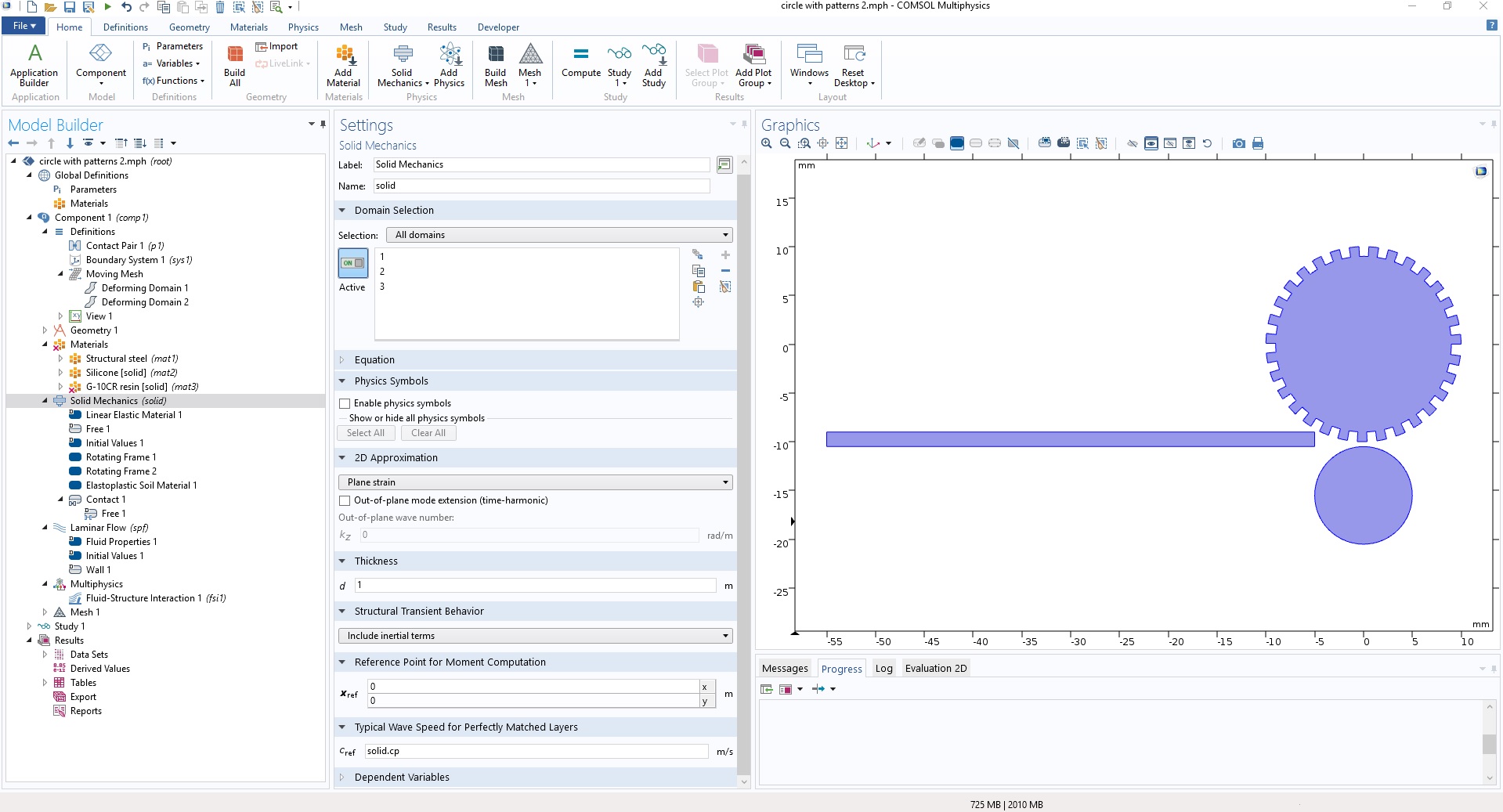

i need help in order to simulate the roll to roll cylinder with patterns . in which a fluid element placed on a plastic sheet i want to move this fluid channel between two rotating cylinder. i used solid mechanics modeule together with FSI module. actually i want to translate the fluid element between two rotating cylinder what boundar conditions i need to give for the translation of fluid element placed on plastic sheet. please see the attched file for further details. what is suitable method to simulate this problem.
