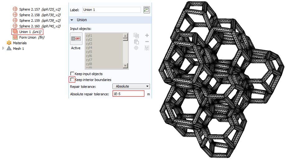

Posted: 7 years ago 4 févr. 2019, 14:54 UTC+1
Sephia,
To mesh geometry, add Union and make sure to clear box "Keep interior boundaries", otherwise meshing would fail.
Sergei
Sephia, To mesh geometry, add Union and make sure to clear box "Keep interior boundaries", otherwise meshing would fail. Regards, Sergei
Posted: 7 years ago 4 févr. 2019, 18:33 UTC+1
Dear Sergei,
Thank you for the reminder, it was not clear for me what consequences "Keep interior boundaries" would result in.
I now have a simplified prototype model that works thanks to everyone. While I am happy that everyone's expertise helped me move forward, I now understand that there is certainly no way I can upscale the complexity of my model, which was the intention from the beginning. I have attached one of my most complex models down below, you will see what I mean.
Best regards, Sephia
