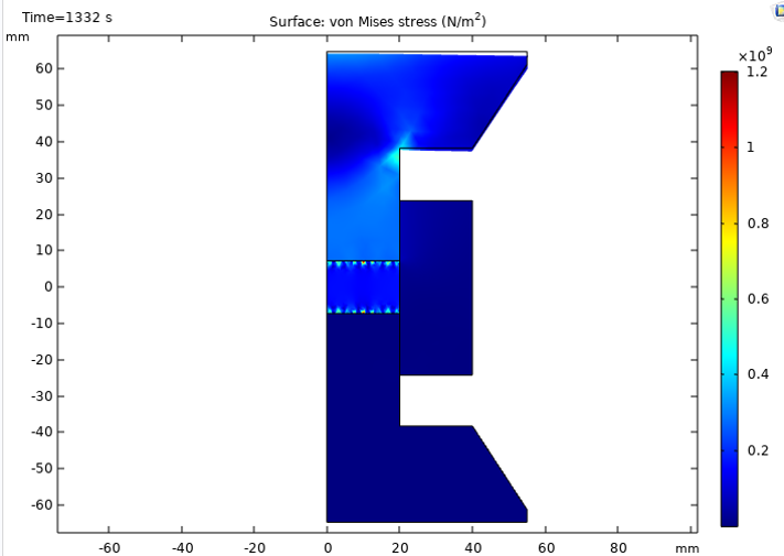

Some suggestions:
- My first guess is that this is related to the mesh resolution. Check that you have a finer mesh on the destination side than on the source side.
- If you are using the penalty method, switch to augmented Lagrangian.
- Check that the solution is converged by reducing the tolerance.
- Plot solid.misesGp rather than solid.mises.

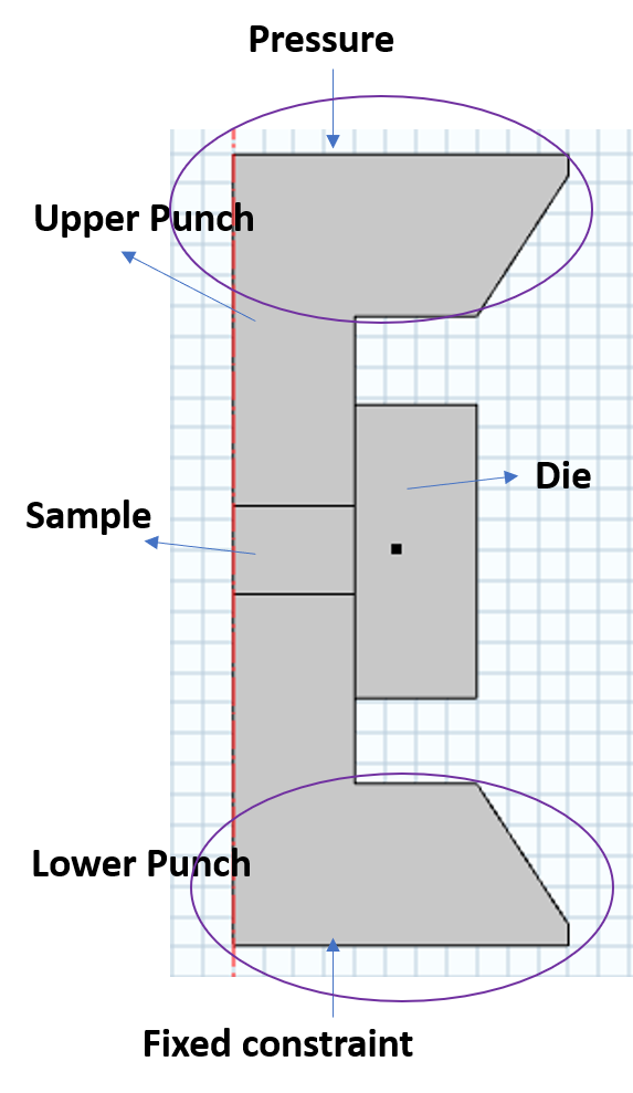

Thank you Henrik,
I tried to use the augemented Lagrangian method, however, I always got the error message:
Nonlinear solver did not converge.
No convergence, even when using the minimum damping factor.
Time: 0 s.
Last time step is not converged.
I tried to change the initial value, but without any sucess:(
would you mind checking my model? Thank you!
Yun
