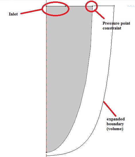

What I know about open boundary is, it could play roles as both inlet and outlet so I am not sure is the suggested way (“define another wall as an open boundary, or as an outlet and set the pressure there to be 0”) suit in my case or not. Can I have ur opinion? Below is my case description:
The fluid filling into a closed chamber through inlet and there’s no outlet - no fluid should escaped out from the rigid chamber (attached condition.jpeg). In order to obey mass of conservation, I prescribed the volume expansion by using ODE function to define the increment of boundary’s length (instantaneous radius and height change) according to inlet flow.
The information I have are inlet velocity and volume expansion pattern. However, I can’t run simulation without define pressure somewhere. What I do now is, impose a pressure point constraint (constant pressure value) on the model. But it took me days to run the simulation!
Looking forward for your reply. Thanks a lot!

The pressure in the balloon is not homogeneous and the pressure allong the balloon wall will change.
If there is no opposing force to the flowing liquid, it is just like flowing a liquid through a nozzle and I think the slosh tank example should help you. You define a volume force on the liquid and the liquid will change shape using the deformed mesh function.
However, if there is there is an opposing force to the liquid, the liquid is ment to flow in a certain shape, you will have to model the opposing force at that wall on the liquid, and you will need FSI for that I think. Unless you have a good way of describing the pressure of the wall on the liquid as a function of x y and t. I think though that that is very difficlut to describe.
