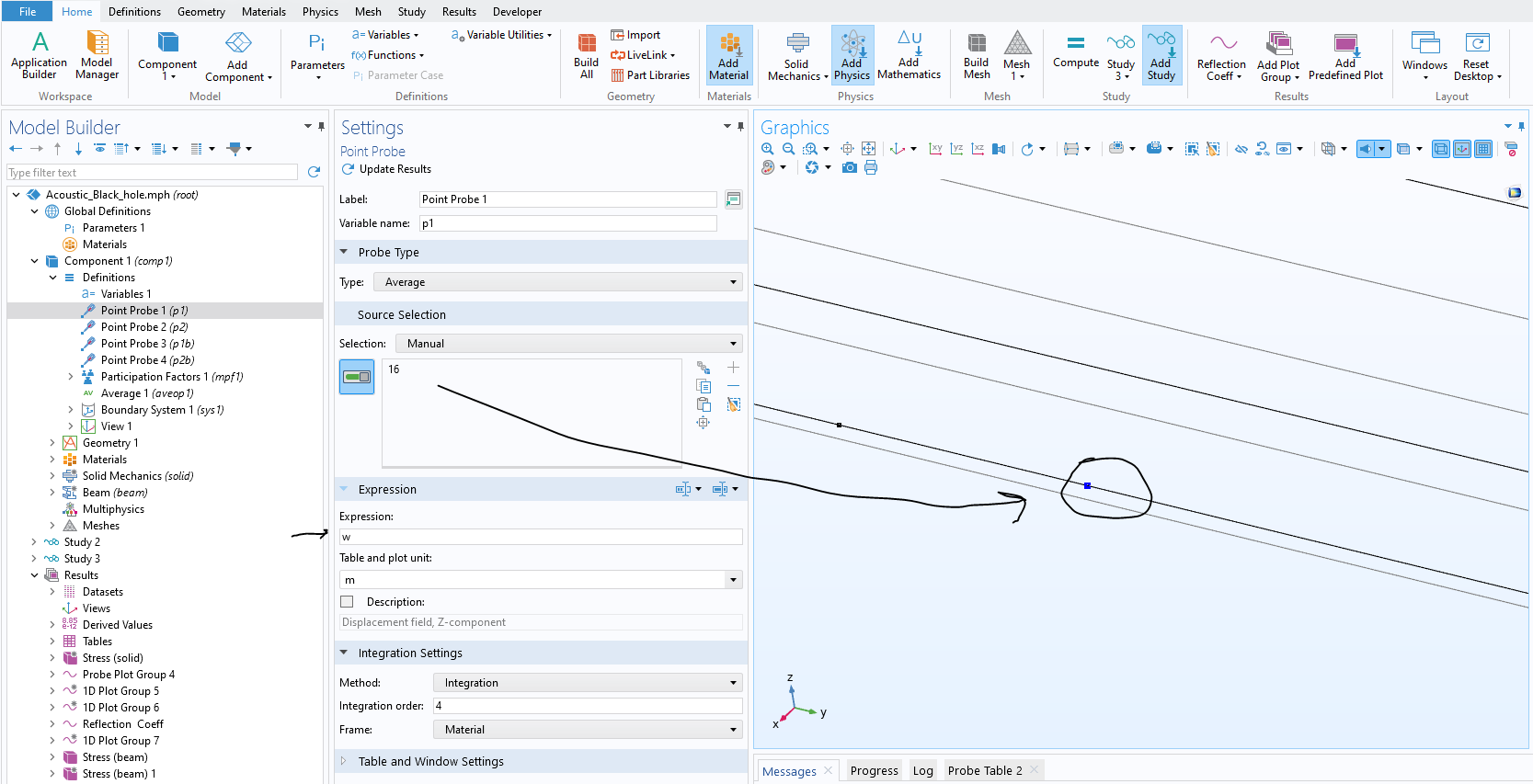

The dispalcement is calculated when solving the study. The point probe stores displacement value at a particular point. For example in the screenshot, point probe 1 is setup to store the z component of displacement at point 16. It is stored to a variable named p1.
Posted: 3 years ago 29 mars 2024, 19:19 UTC−4
I understand. And with these displacements how would the total reflection coefficient be plotted?
