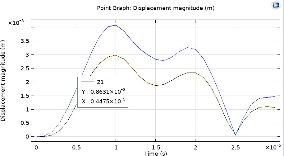

Thank you for the recommendations. I tried to implement them. I slightly changed the boundary condition - changed the Roller mounts to Fixed. Accordingly, the frequency has changed (I use 38270 Hz). The shape of oscillations in the Eigeinfrequency mode corresponds to the Frequency Response mode (Screenshot_3 + Screenshot_4). The shape of oscillations looks like a traveling wave in several points. The analytical formula became 100sin(pi38270*t).
In the Time Dependent: range(0,1.0e-6,3.0e-5 [s]); Tolerance - user controlled; Relative tolerance - 0.0001.
In the section Direct: Solver - SPOOLES; Preordering algorithm - Nested dissection; Pivot threshold - 0.1.
In the section Time-Dependent Solver: Solver tipe - Implicit; Method - Generalized Alpha; Step taken by solver - Manual; Time step - 1.0e-6; Absolute tolerance - 0.0001.
In the section Fully Coupled: Maximum number of iterations - 100.
But unfortunately the result for Time-Dependent mode has not changed (Screenshot_2). The shape of oscillations remains the same as in static mode, compressing and uncompressing along the thickness. By the way, if you plot the Point Graph, you can see that the oscillation frequency corresponds to approximately 1 Hz, i.e. the specified frequency is not applied in the calculation (Screenshot_5). Maybe I have set something wrong? What else can be done?

As Henrik commented, the mode won't build up after just one period. It also depends on the way you apply the exciting load. It may or may not couple well into the specific mode.

I needed to increase the measurement time without changing the step. I did so range(0,1.0e-6,300.0e-5), that is, I increased the measurement range by 100 periods. At the first periods it is purely static mode, and then the mode of oscillation of the set frequency, which coincides with the modes Eigeinfrequency and Frequency Response, began to appear.
But still it somehow echoes the static mode. Maybe it is necessary to increase the measurement time?
And I understand that the result analysis should be done on the last periods of the specified range, the initial results should be simply ignored.

The time required for a transient analysis to reach steady state depends on the amount of damping in the system and can be extremely long if there is little damping. (100 periods is nothing as quality factors can be...tens of thousands in some systems).
It is not clear why it is necessary to do a transient analysis. If really necessary it may be possible to approach the steady-state solution by choosing the "right" initial condition. Alternatively some insight might be gained by increasing the damping, especially if there is additional damping in the actual physical system.
