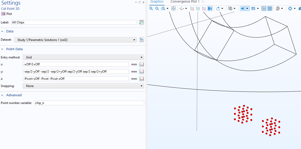

I have created a 3D simulation of an arc magnet that moves around in space, and want to evaluate the z component of field at specific points within a 3D Cut Point dataset.
Obviously if the dataset had 1 discrete point, I would just evaluate mfnc.Bz for the dataset.
However, with a grid definition of the dataset (see attachment) I want to evaluate it at a specific point within that grid definition. I have customised the point number variable to be "chip_n" so clearly need to use that within my expression to evaluate, but I cannot determine what the correct syntax for this is!
In my attached example there are 54 discreet points defined by my grid, and I would like (for example) to determine the difference in the z field at points 1 and 10.
Thanks in advance for your guidance...
Mark

There's no expression syntax for referring to a point that has a certain value of chip_n. It might be possible to do what you want using a Point Evaluation in a Derived Values or an Evaluation Group: I think that the points are ordered in increasing order with respect to chip_n, and if they aren't, then you can evaluate chip_n in addition to the expression that you are interested in. This leaves you with a table of values. You can create a model method that extracts the values you're interested in. This is admittedly more complicated that a dedicated expression syntax would have been.

I think the best available solution is to use the at function.
For example, to evaluate mfnc.Bz at a position of (x1,y1,z1), you would use:
at3_spatial(x1,y1,z1,mfnc.Bz)
This is for a 3D model, you would use at1 or at2 for lower dimensions.
As alluded to above, I do not think the object model drills down to the granular level needed to expose the individual locations of a Cut Point grid dataset.
I think the best available solution is to use the ***at*** function. For example, to evaluate mfnc.Bz at a position of ***(x1,y1,z1)***, you would use: ***at3_spatial(x1,y1,z1,mfnc.Bz)*** This is for a 3D model, you would use at1 or at2 for lower dimensions. As alluded to above, I do not think the object model drills down to the granular level needed to expose the individual locations of a Cut Point grid dataset.
