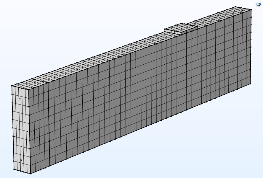

  • Improve the mesh, see attached image for the mesh I used.

With these changes I can solve study 2 and get a ultimate load of approximately 225 kN compared to 260 kN from study 1.

How did you mesh this mesh with the tendons? Also there is no symmetry with these tendons!.
