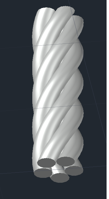

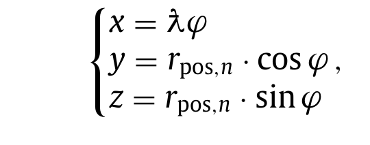

I know that it is a very easy task. but somehow, I am unable to obtain the twisted structure. I desired helical model, governing equations for helix and my mph model are attached below.
Please help me.
1 Reply Last Post 1 mai 2025, 02:28 UTC−4
Posted: 6 months ago 1 mai 2025, 02:28 UTC−4
Updated: 6 months ago 1 mai 2025, 07:38 UTC−4
I have finally found the solution. my equations and procedures are correct. I just required to change some parameters in the sweeping process.
Motion of cross section == Twisting == Follow curvature vector
advance setting == geometry representation == Bezier (optional)
Hope it would be helpful for someone.
