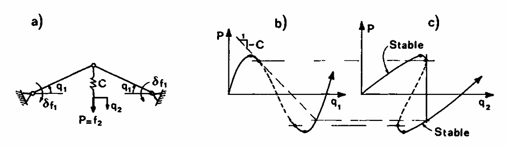

I am working on a COMSOL model where I want to connect a Truss structure to a Lumped Mechanical System (LMS) physics, as shown in the attached figure. I am unsure of the proper method to link the truss element with the LMS domain.
What is the correct way to couple the Truss to LMS in COMSOL? Should I use Multiphysics couplings, boundary conditions, or some other approach?

You can use the Lumped–Structure Connection multiphysics coupling to connect the interfaces.
Regards, Soumya
