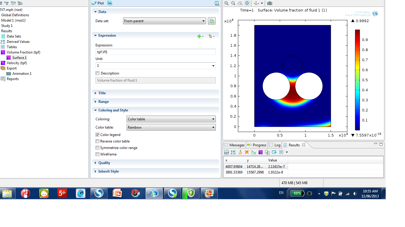

I simulated a droplet falling and passed through the small gap between two solid balls. As the surface tension of the droplet, some part of liquid is kept between two balls. Now the result is the volume fraction figure which descrbe liqud by percentage, not real volume. anyone can help me find the volume between two solid balls( the volume of initial droplet already know) ?

- I think that the only way to compute the total volume of the liquid is to integrate in volume the function (tpf.Vf2>0.01), this function is 1 if tpf.Vf2 is greater than 0.01 and 0 otherwise. If there is another way to do this, I also would like to know.

Hi, thanks for your suggestion. and I integrated the Tfv2 but the mass seem not conservation. some problem with that? I have not try outlet yet, but I really like to do it, and see how 's going!

- If you are computing the mass, you should make the integration (tpf.Vf2>0.01)*tpf.rho, the density changes in the zone between different phases.
- I noticed that comsol suffer of some numerical diffusion in the solution. In a 3D case I have more severe mass losses. I can only convergence cases with triangle or tethaedral meshes, which is very strange to me since any CFD code with FV method can use cartesian grid. Refining the grid or using the adaptive refinement option reduces this mass losses.
