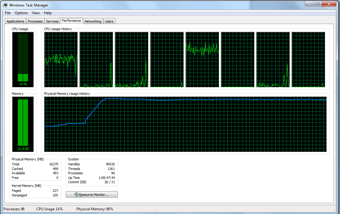

I have attached the image of task manager

I am working on a system with 16 GB RAM, too. With the magnetic and electric fields interface, I can usually handle up to 300.000 mesh elements without problems.
Modify the mesh until your model fits into the memory (COMSOL task should not allocate more than 14 GB).
Or you approach the problem from the other side: Start with a very coarse mesh, solve the problem, create a finer mesh, solve the problem, create a more finer mesh, solve, and so on. Until the accuracy of the solution is good enough or until you reach the 14 GB limit.
