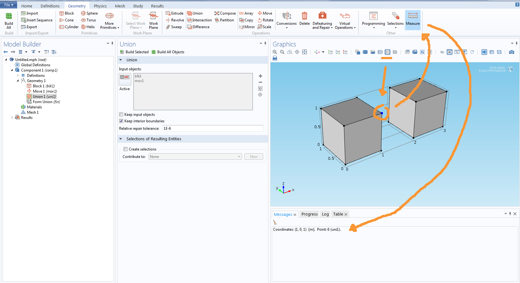

In COMSOL you can find the location of an object, or more specifically of a point as follows:
- Go to geometry
- change the entity selection to point
- select one point (only) of which you want to have the location
- go to the geometry tab in the ribbon, and choose "measure" (at the end of the ribbon)
- In the messages window you will get the x, y and z coordinate of that point
I attached a screenshot which shows where to find the buttons.
