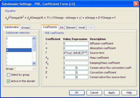

Posted: 2 decades ago 29 oct. 2009, 15:29 UTC−4
Here is what I have done...
Use the PDE, Coeffient Form (c)
Select the subdomains that will be active for the calculation... In Roberts case, the tissue...
Set f (source term) to A*exp(-deltaE/(R*T))
Set da (damping/Mass coefficient) to 1
All other variables to 0
I use Omega for c when I initiate the physics in the modeler...
Your equation will then be dOmega/dt = A*exp(-deltaE/(R*T)) or rearranged dOmega = integral (A*exp(-deltaE/(R*T)),dt) - see attached...
Here is what I have done... Use the PDE, Coeffient Form (c) Select the subdomains that will be active for the calculation... In Roberts case, the tissue... Set f (source term) to A*exp(-deltaE/(R*T)) Set da (damping/Mass coefficient) to 1 All other variables to 0 I use Omega for c when I initiate the physics in the modeler... Your equation will then be dOmega/dt = A*exp(-deltaE/(R*T)) or rearranged dOmega = integral (A*exp(-deltaE/(R*T)),dt) - see attached...

Posted: 2 decades ago 23 déc. 2009, 12:17 UTC−5
One problem that I have run into with this approach is that the numerical value for Omega can be so large as to cause problems. The most significant problem is that there is a huge Omega gradient that results. Yet typically, the mesh that is being employed has been optimized in terms of element size and spacing, for the thermal solution, and not for the solution of Omega. This causes inaccuracies in the solution for Omega.
One way to improve this is limit the magnitude of Omega. Since Omega greater than 5 is indicative of cellular destruction and destruction is not reversible, there is no need to keep accumulating damage much beyond 5 and create a huge Omega gradient that can lead to inaccuracies.
One way to implement this is to set f (source term) to a variable which is equal to a user-defined function rather than to A*exp(-deltaE/(R*T)). The function can be imported as a look-up table from Excel or matlab. I use excel to compute Omega from 273 K to the upper limit of my temperature range. Then I edit the table to clip the value of Omega to say 7 and import this modified table into COMSOL.
One problem that I have run into with this approach is that the numerical value for Omega can be so large as to cause problems. The most significant problem is that there is a huge Omega gradient that results. Yet typically, the mesh that is being employed has been optimized in terms of element size and spacing, for the thermal solution, and not for the solution of Omega. This causes inaccuracies in the solution for Omega. One way to improve this is limit the magnitude of Omega. Since Omega greater than 5 is indicative of cellular destruction and destruction is not reversible, there is no need to keep accumulating damage much beyond 5 and create a huge Omega gradient that can lead to inaccuracies. One way to implement this is to set f (source term) to a variable which is equal to a user-defined function rather than to A*exp(-deltaE/(R*T)). The function can be imported as a look-up table from Excel or matlab. I use excel to compute Omega from 273 K to the upper limit of my temperature range. Then I edit the table to clip the value of Omega to say 7 and import this modified table into COMSOL.
Posted: 2 decades ago 23 déc. 2009, 17:25 UTC−5
Couldn't you do the same thing by limiting f to calculating f up to 7.... (f<=7)(A*exp(-deltaE/(R*T))) that way it will only sum if the f term is less than or equal to 7.

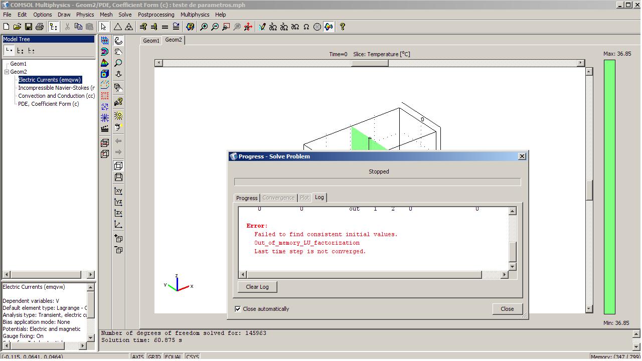

Posted: 1 decade ago 18 avr. 2012, 21:42 UTC−4
Hi Jason,
I need help! I am trying to apply an Arrenhius damage integral DURING the solution of an thermal ablation problem using the heat Transfer and PDE coefficient form Modules (T and u are the dependent variables). In the end of the simulation, it appears the following message:
"Error:
Failed to find consistent initial values.
Out_of_memory_LU_factorization
Last time step is not converged."
Any help is WELCOME!
Cleber
Hi Jason, I need help! I am trying to apply an Arrenhius damage integral DURING the solution of an thermal ablation problem using the heat Transfer and PDE coefficient form Modules (T and u are the dependent variables). In the end of the simulation, it appears the following message: "Error: Failed to find consistent initial values. Out_of_memory_LU_factorization Last time step is not converged." Any help is WELCOME! Best regards, Cleber

Posted: 1 decade ago 26 avr. 2012, 12:36 UTC−4
Hi Jason!
I have committed a mistake: I forgot to inform the description of fluid mechanics on my simulation. Actually, I am using the heat transfer, PDE coefficient Form(c) and incompressible Navier-Stokes modules. The u variable describes the fluid velocity in this last modality of Physics.
The values for Ea and A are:
Ea=6.65x10^5 J/mol;
A=1.98x10^106 1/s
The link below illustrates the window of the software COMSOL:
www.comsol.com/community/forums/general/download/file/12973/error%20Failed%20to%20find%20consistent%20initial%20values.JPG
Sincerely yours,
Cleber Pinheiro
Hi Jason! I have committed a mistake: I forgot to inform the description of fluid mechanics on my simulation. Actually, I am using the heat transfer, PDE coefficient Form(c) and incompressible Navier-Stokes modules. The u variable describes the fluid velocity in this last modality of Physics. The values for Ea and A are: Ea=6.65x10^5 J/mol; A=1.98x10^106 1/s The link below illustrates the window of the software COMSOL: http://www.comsol.com/community/forums/general/download/file/12973/error%20Failed%20to%20find%20consistent%20initial%20values.JPG Sincerely yours, Cleber Pinheiro

Posted: 1 decade ago 27 avr. 2012, 14:02 UTC−4
Have you been able to run the thermal/fluid interaction without the Arrenhius damage integral? If the thermal/fluid interaction does not solve, that may be where your error is coming from.
Posted: 1 decade ago 16 mai 2012, 23:54 UTC−4
Hi Jason!
yes, I run the thermal/fluid interaction without the Arrenhius damage integral (NO PROBLEMS in this simulation). So, the thermal/fluid interaction is independent of the damage integral.
Cleber Pinheiro
Hi Jason! yes, I run the thermal/fluid interaction without the Arrenhius damage integral (NO PROBLEMS in this simulation). So, the thermal/fluid interaction is independent of the damage integral. Best regards, Cleber Pinheiro
