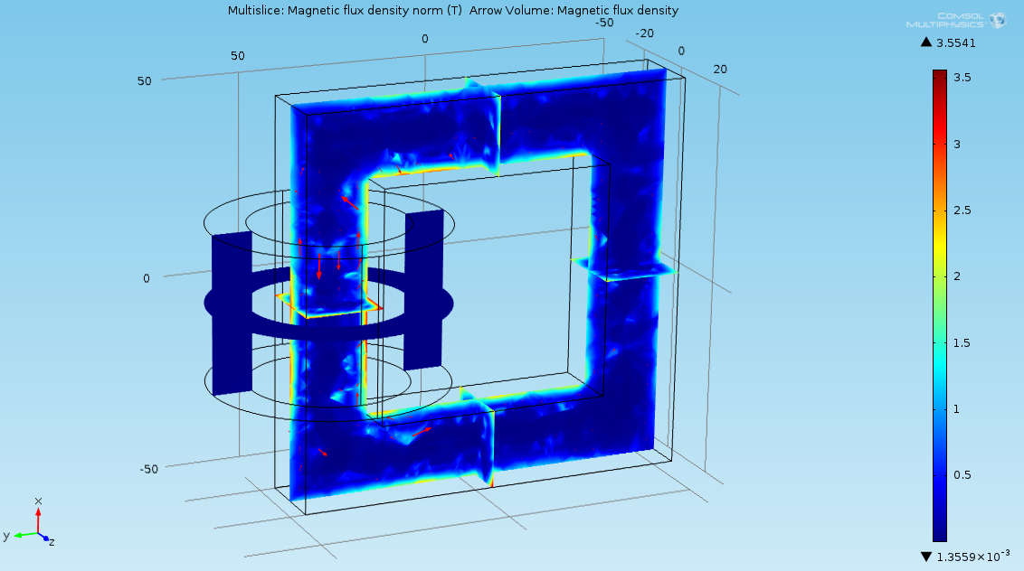

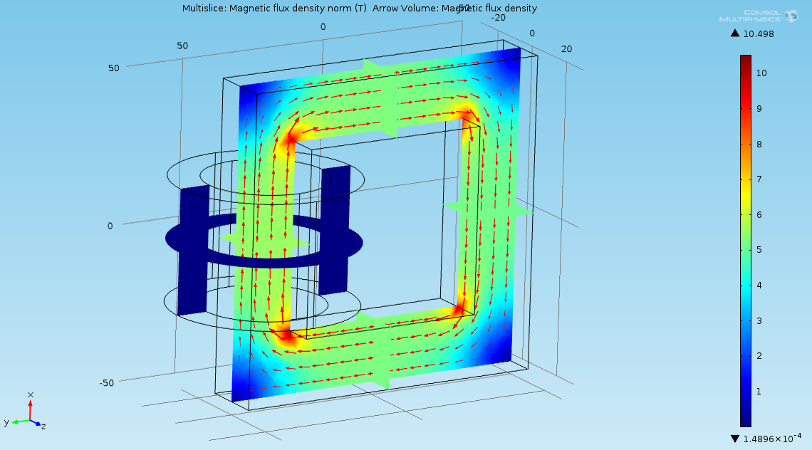

I am simulating an electromagnet dipole and I would like to simulate the iron as a laminated core instead of a solid core.
Is there any way to set the filling factor and the lamination directio or I should design each layer (which would be crazy)?

Is there any example I can use as a reference?
Check the attached model.

I would like to ask you something regarding your model:
1) how do you take into account the fact that your core is missing a certain percentage of magnetic material?
I mean, if laminated, the core will be made of layer of metal and insulator, henche the core will have a magnetic material volume smaller than 100% of the yoke volume. This can be described by a filling factor usually, but I don't know how to set it i comsol.
2) I use single coil turn with an inner surface as gap feed. There are advantages in using the multi turn coil, as you did?

1. The attached model was just an example of how to use material conductivity settings in order to prevent undesired eddy currents in the core. There is no (as far as i know) straightforward way to define core filling factor. You can reduce core permeability (depends on the permeability settings you use) in order to get the desired flux.
2. Sure, any type of coil and excitation can be used. Multi-turn coil was used just for the example.
