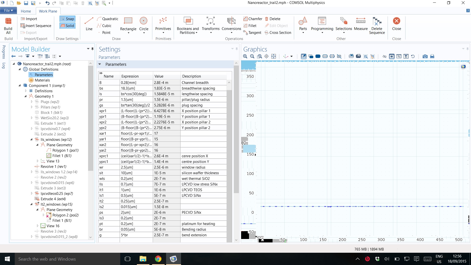

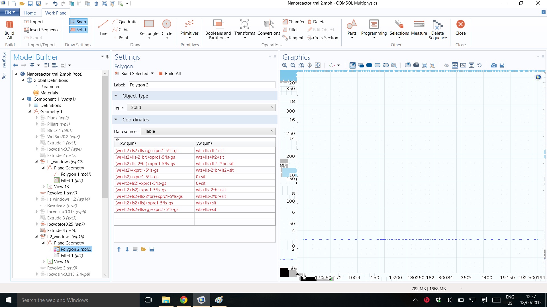

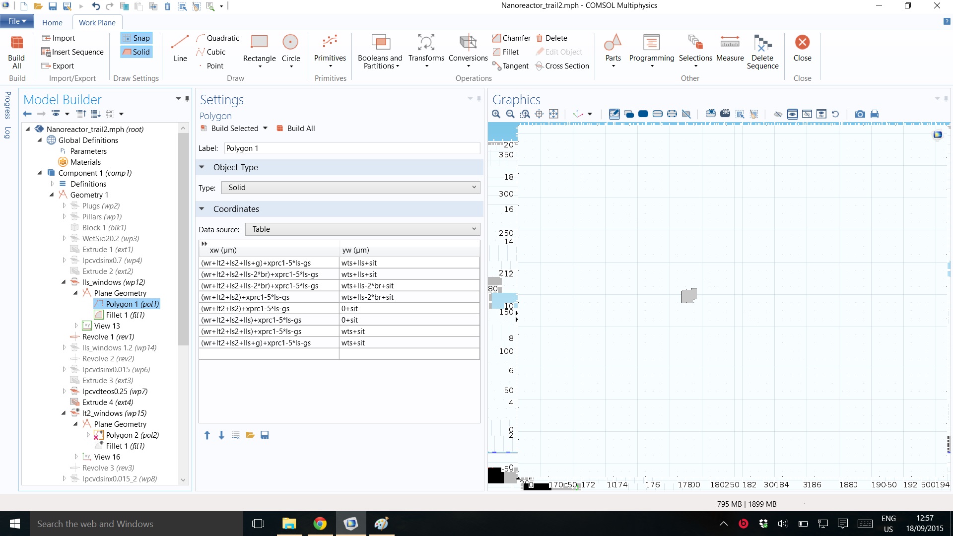

I specified all the required parameters under definitions. I builded many other structures using those parameters. Now i'm trying to build a polygon in a work plane (I previously a polygon using those parameters in another work plane). I don't have a clue why it is not working this time. for further understanding pls ref to the screenshots attached.

I sometimes see this behavior too. Sometimes it helps to click into the Parameter table and back to the geometry definition. Sometimes I have to delete the parameter (not the whole list) and enter it again.
