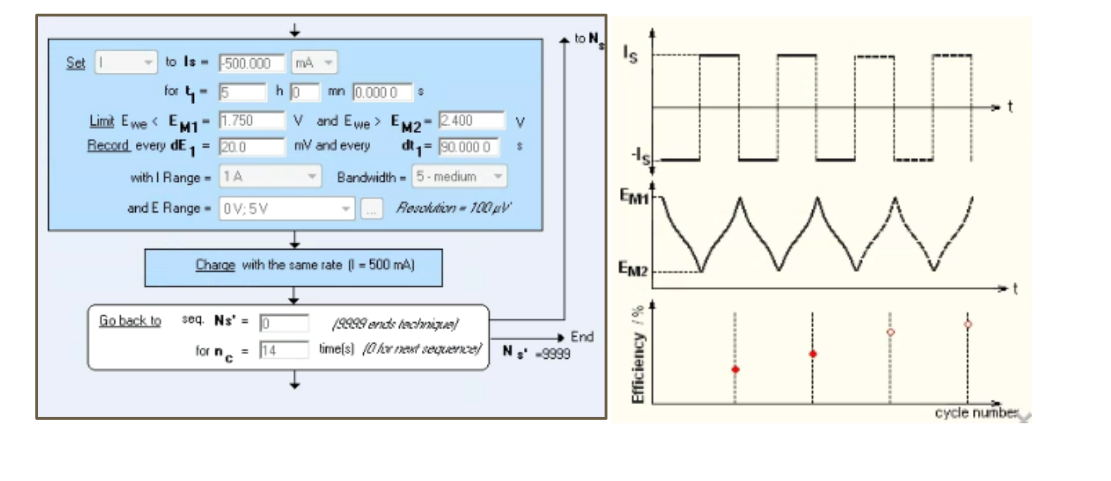

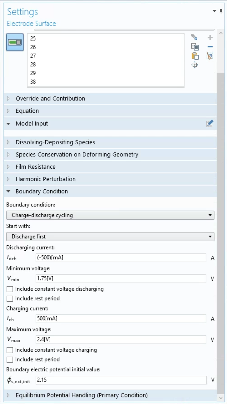

I'm trying to simulate a constant current charge-discharge cycling of a battery cell using Tertiary Current Distribution Physics.
However on the Charge-discharge cycling boundary condition, the option is limited to minimum and maximum potential as well as the start condition. Is there a way that I can do to a similar boundary condition that was utilize in most potentiostat (see attached photo).
I need to implement both as I'm trying to simulate cycling based on a known testing standard used by manufacturers.
